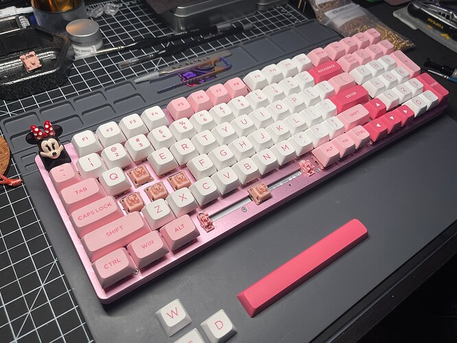

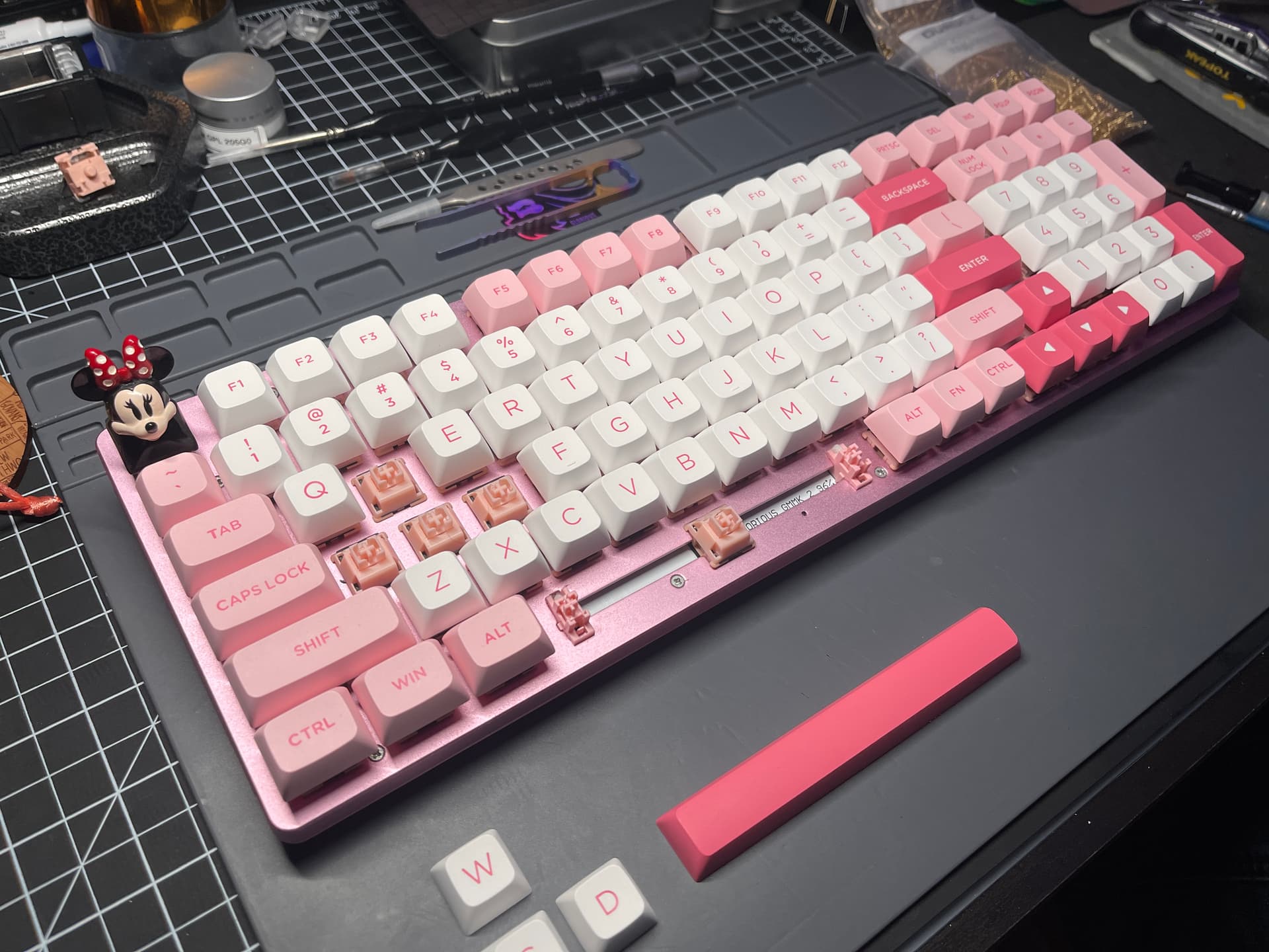

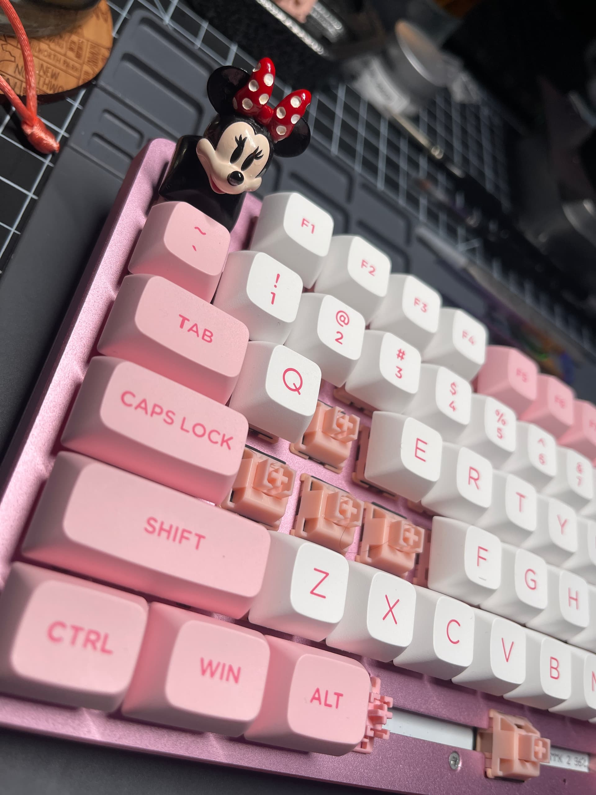

Finished up the GMMK2 build for my family member. Her two requests were “make it as pink as possible” and “something with Minnie Mouse on it.”
I nailed both, but man was it a struggle with this board…
I wanted to keep it on the quieter side as well as be comfortable to type on all day and do data entry for her job. Getting the sound right took the most time and included me using Killmat as well as some PE foam behind the number and F-row. The PCB had three layers of tape as well.

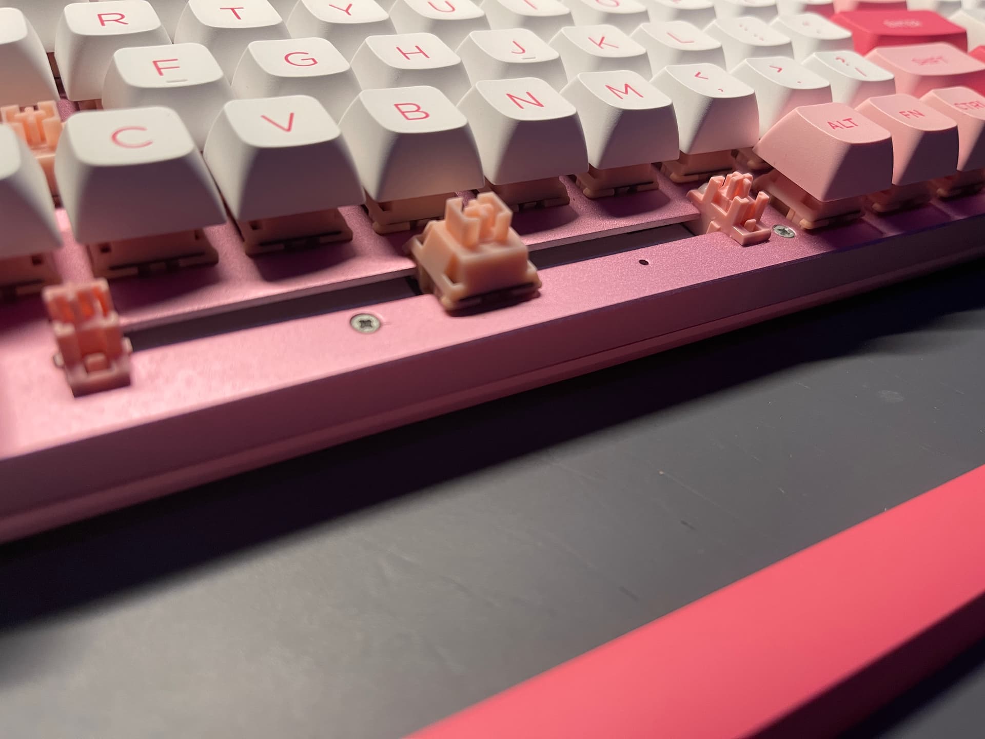

Then the stabs…:disappointed_face:
Oh man, I tried everything to get the stock stabs to work. Shims, clipping and sanding the feet, holee modding them, different wires… Nothing seemed to work. I then picked up a set of plate-mounted stabs from EPOMAKER (bonus: they were pink😉) and they fit PERFECTLY!!
I lubed and filmed some Aurora Pink switches from Wuque Studios and was surprised at how closely they matched the color of the stabs. Also, they are pretty smooth with the factory lube, so I just bag lubed the springs in 105 and threw some switch film from Deskeys in them and they were perfect. I had also applied some switch pads from KBDFans on the PCB to help quiet things down.
Finally, I picked up some ASA profile keycaps from Akko and a Minnie Mouse artisan from a shop on Etsy.
It may not be for everyone, but family builds get extra love and attention, so this one wasn’t going to leave the work bench until it was perfect. :smiling_face:
Nice that is 100% :fire: I’m sure she is gonna love typing on it. Great job on all the work you put into making it perfect for her
Looking solid! Pics when done please!
This board looks amazing! Nailed the theme. I hope the recipient appreciates how nice the little touches are.

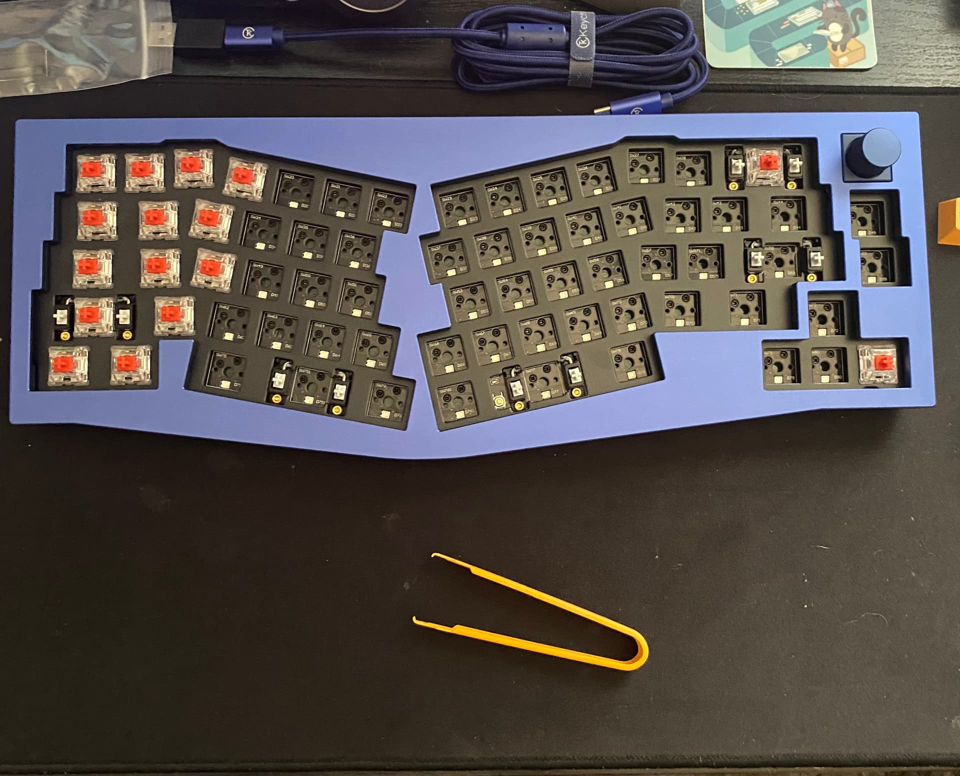

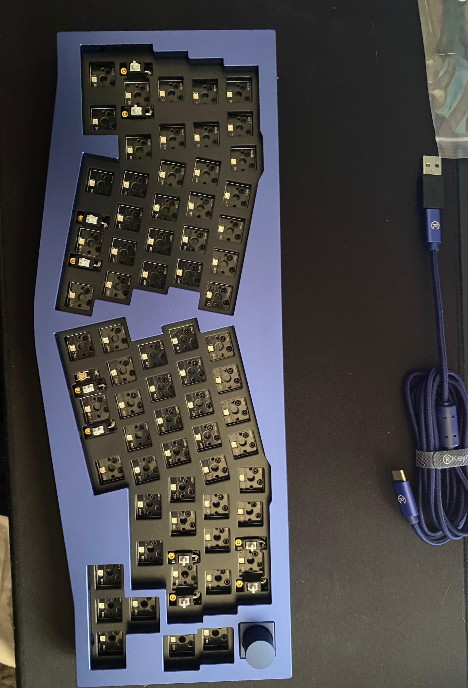

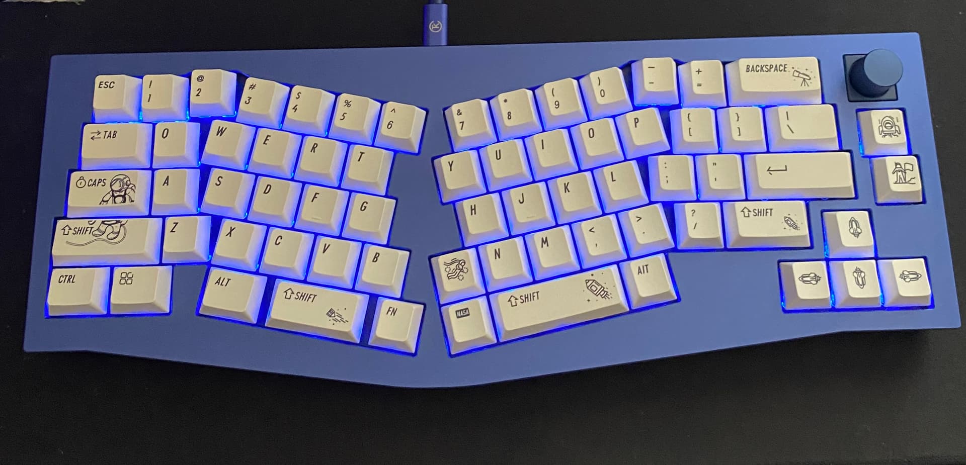

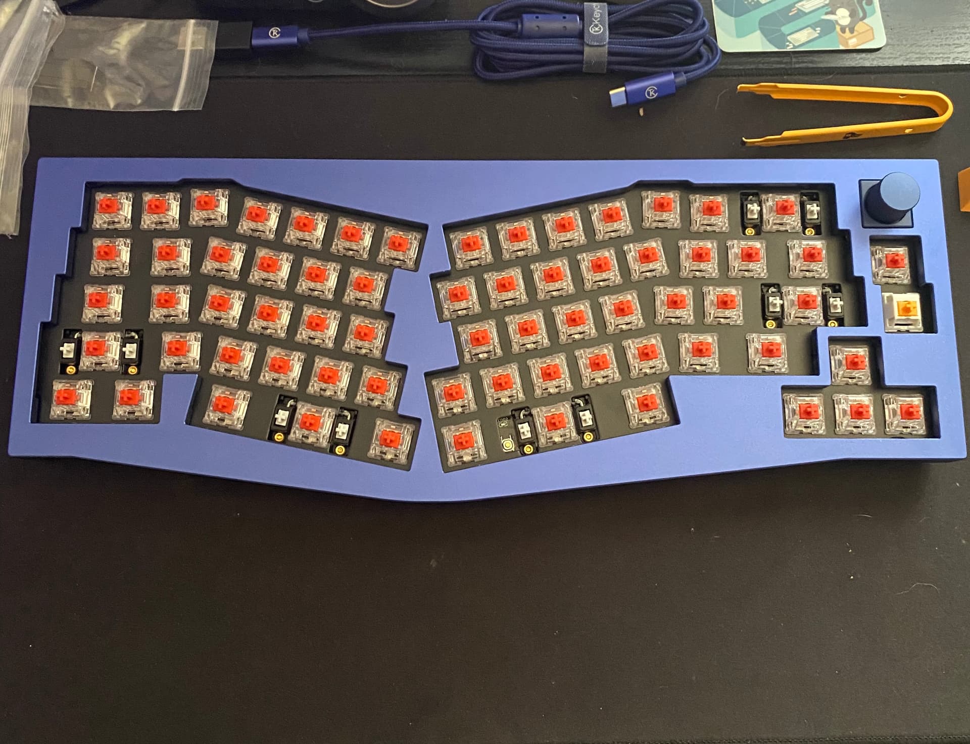

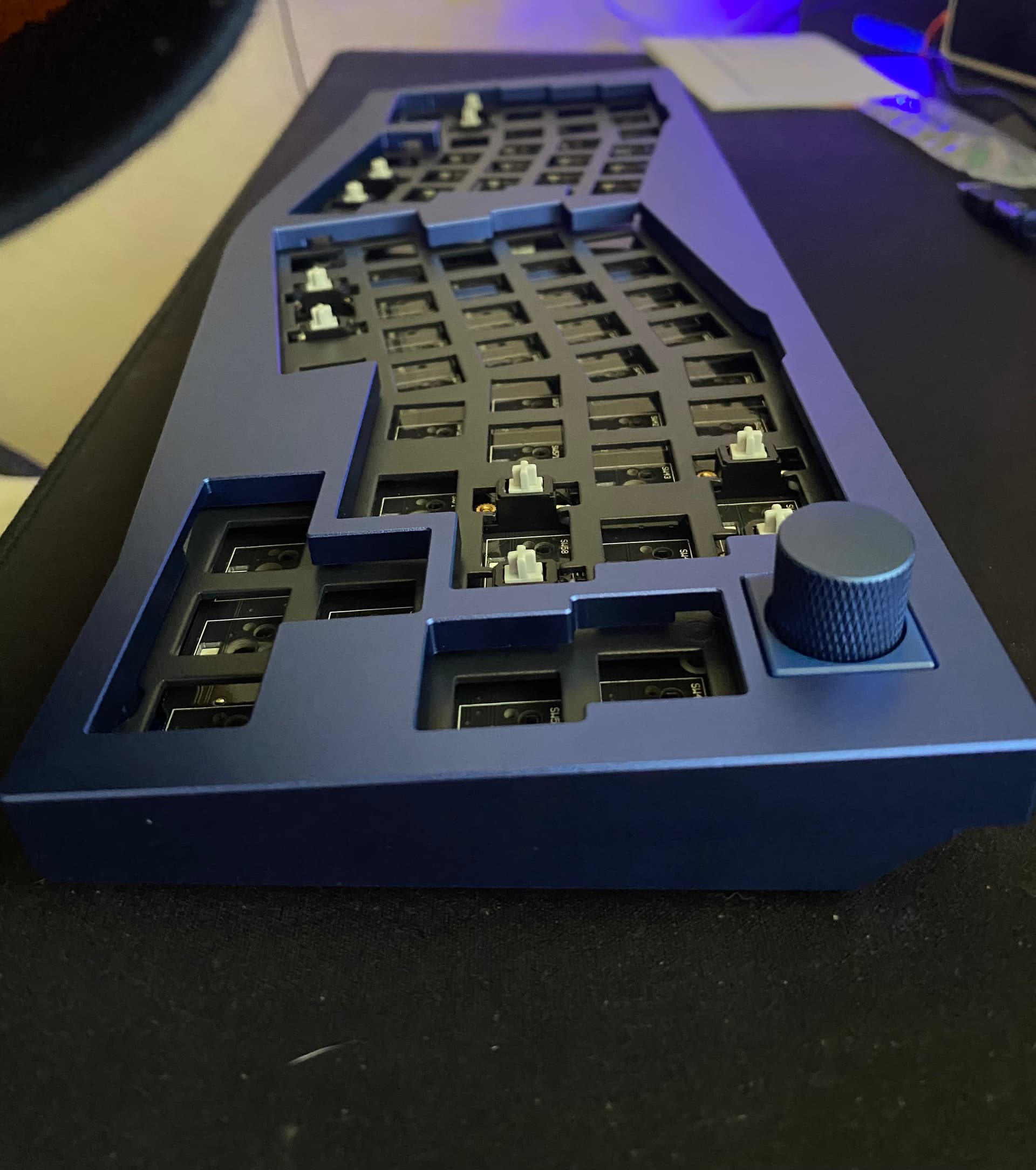

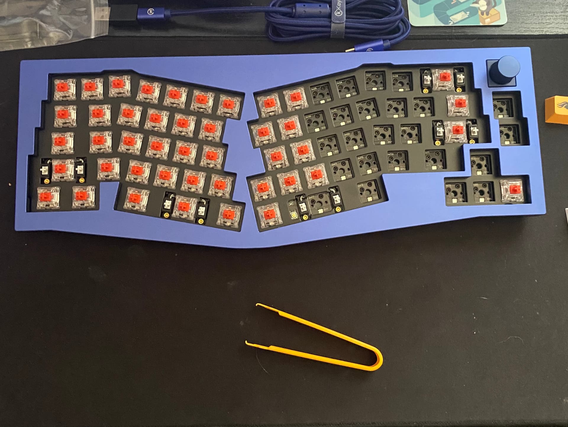

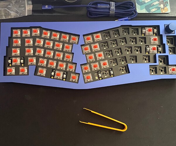

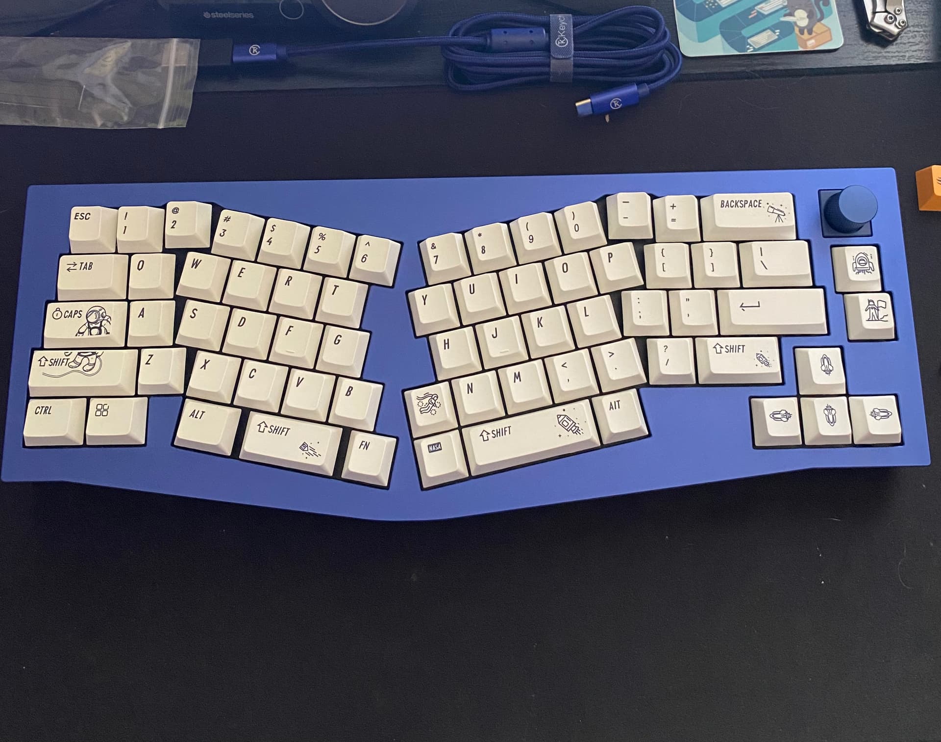

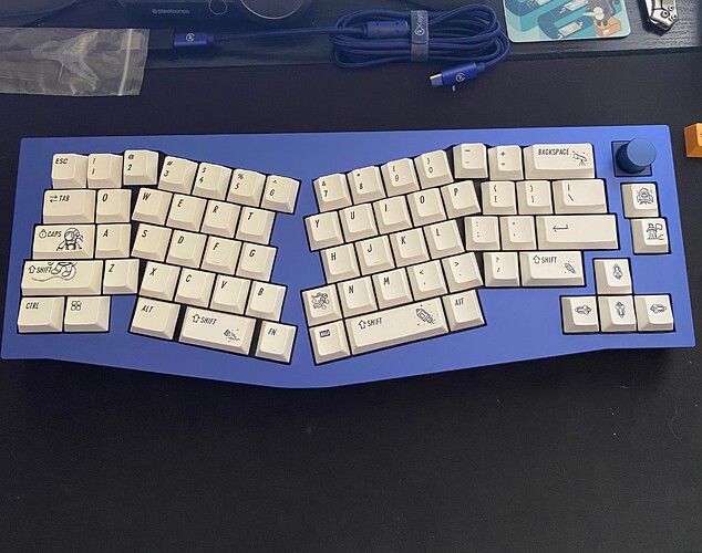

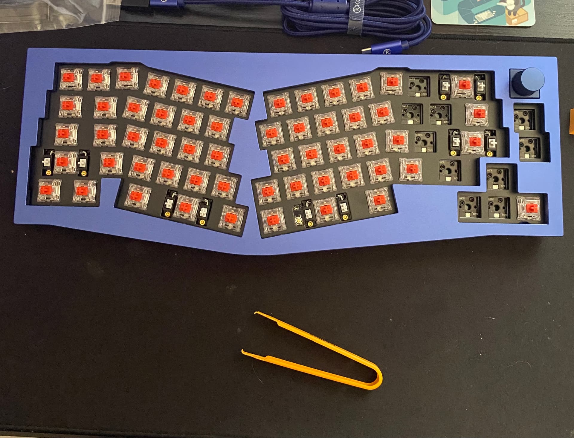

Here is my Keychron Q8 w/ Fox Switches and Space Themed Keycaps. Once the Spellbook Keycaps and Oil Kings arrive I will swap them out. Also the Spellbook Keycap Set has the actual space bars and two B Keys instead of using Shift Keys for the space bar and a random Novelty Key for the extra B like I am with the Outer Space Set
The pictures don’t justify the actual boards color. The blue is really nice looking. The sound profile so far is a little metaly sounding right now. I might think about getting the FR4 Plate for it and seeing if that helps with the sound. There is a lot of give to the board with the gasket mount and I really like how it feel. I had to use one Panda Switch to finish out the build because the Q8 has one extra key then the GMMK2. I am typing on it right now and it is a little strange to type on and you have to get use to not reaching over to hit certain key’s but I am liking it quite a lot so far
You get used to the layout pretty quickly - easily my favorite layout is the Alice/Arisu. And that’s the nice thing about those sets that NovelKeys sells is that the kitting is really nice for the price, unlike GMK sets which typically bundle spacebars as their own kit.
Yeah I absolutely agree about the Keycap set from NovelKeys. Yeah I think I am getting use to it pretty quick, I think the hardest part is the space bars lol
I went with FR4 on my Q1 and it definitely helped the sound profile out. I have FR4 on one of my GMMK Pros and POM on the other, and like both for different reasons. That’s what I love about this hobby is all of the different options you can tune a board to sound good to you!
Absolutely. I am also thinking I will try some Durock 0.5mm Switch Pads before I try the FR4 plate then I will try the FR4 plate with and without switch pads and see what I think sounds better
I have used switch pads in all of my builds. If you thought filming switches required a steady hand… Oh boy! :joy::joy::joy:
Yeah and I always get nervous when I start to pull my keyboard apart lol, gotta keep them hands steady. I have not done any switch filming yet, a few of my next projects are doing my own lube and switch films and also learning how to solder. I also have been watching a lot of video’s on how to build, program and code my own PCB from scratch to build my own keyboard. So I want to learn how to use like KiCad, AutoCad, or Ergogen and really learn how to build a keyboard from the ground up
