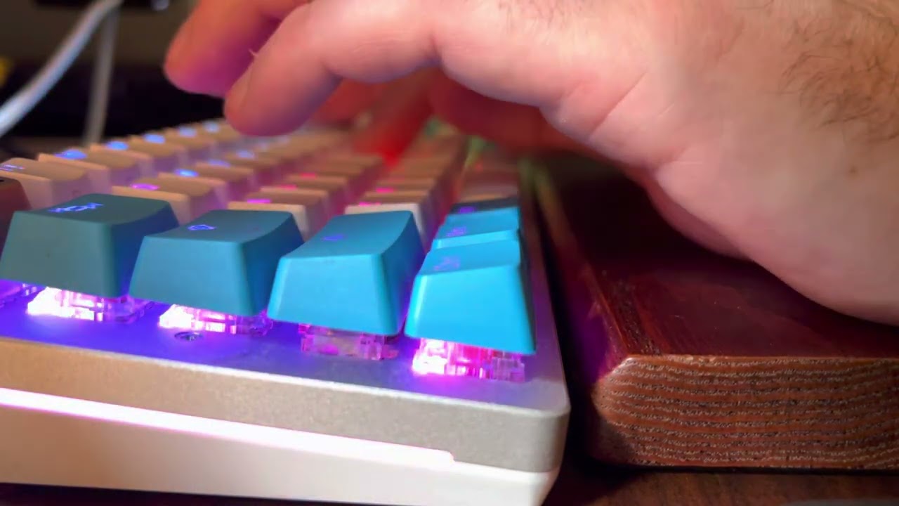

I’ll try to snag an audio sample and post it. It’s like butter.
@TechwithCraw Here is what this thing sounds like. Note: The mic is close to the board, but it’s a pretty accurate representation of what it sounds like.
Ohhh that sounds very nice
Very nice @LiquidMaverick ![]()
Great sound!
I put a sound test up on another relevant post for data’s sake.
I applied to my Pro and it gave it additional pop. I definitely like the switch pads more than the PE Foam sheets as I don’t have to think about it every time I am switching out something.
